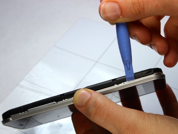

  2. JIAYU F1 Power Button Replacement, Remove the Back Case: crwdns2935265:02crwdnd2935265:01crwdnd2935265:03crwdne2935265:0 JIAYU F1 Power Button Replacement, Remove the Back Case: crwdns2935265:02crwdnd2935265:02crwdnd2935265:03crwdne2935265:0 JIAYU F1 Power Button Replacement, Remove the Back Case: crwdns2935265:02crwdnd2935265:03crwdnd2935265:03crwdne2935265:0
    • Find the small indentation at the bottom right of the phone and pry open the back case of the phone using your fingernail or small plastic opening tool.
    • Gently remove the back case completely from the phone.

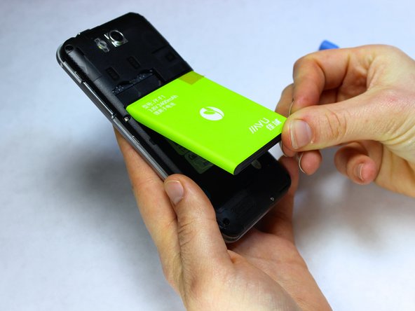

  3. JIAYU F1 Power Button Replacement, Remove the Battery: crwdns2935265:03crwdnd2935265:01crwdnd2935265:03crwdne2935265:0 JIAYU F1 Power Button Replacement, Remove the Battery: crwdns2935265:03crwdnd2935265:02crwdnd2935265:03crwdne2935265:0 JIAYU F1 Power Button Replacement, Remove the Battery: crwdns2935265:03crwdnd2935265:03crwdnd2935265:03crwdne2935265:0
    • Insert a fingernail or the small plastic opening tool into the recess in the bottom center of the battery and lift upward.
    • Remove the battery from the phone.
    • When replacing the battery, align the copper ports on the top right of the battery with the corresponding ports in the battery cavity.

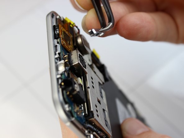

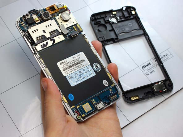

  4. JIAYU F1 Power Button Replacement, Remove the Interior Midframe Assembly: crwdns2935265:04crwdnd2935265:01crwdnd2935265:03crwdne2935265:0 JIAYU F1 Power Button Replacement, Remove the Interior Midframe Assembly: crwdns2935265:04crwdnd2935265:02crwdnd2935265:03crwdne2935265:0 JIAYU F1 Power Button Replacement, Remove the Interior Midframe Assembly: crwdns2935265:04crwdnd2935265:03crwdnd2935265:03crwdne2935265:0
    • With the phone lying face down, remove the nine 3 mm Phillips # 00 screws from the midframe.
    • Gently run a plastic opening tool down along the left and right sides of the phone to separate the black midframe assembly from the silver display casing.
    • Carefully remove the midframe assembly from the display casing by pulling up and away from the phone.

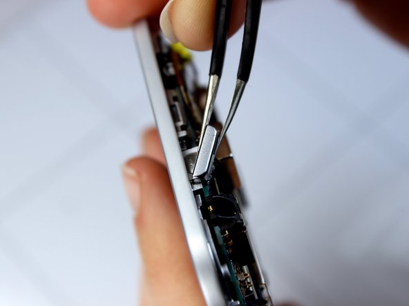

  5. JIAYU F1 Power Button Replacement, Removing Power Button: crwdns2935265:05crwdnd2935265:01crwdnd2935265:03crwdne2935265:0 JIAYU F1 Power Button Replacement, Removing Power Button: crwdns2935265:05crwdnd2935265:02crwdnd2935265:03crwdne2935265:0 JIAYU F1 Power Button Replacement, Removing Power Button: crwdns2935265:05crwdnd2935265:03crwdnd2935265:03crwdne2935265:0
    • Locate the silver power button at the top of the phone.
    • Use the precision tweezers to slide the power button out of the groove.
    • When replacing the power button align the flat side of the button to the silver edge of the display with the rounded edge facing the black frame.
