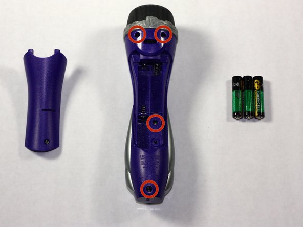

Removing back half of device
  • Unscrew the other 4, #8 11.6 mm Phillips Head screws to remove the entire back half of the device.
  • Pull apart the device once screws are loose, splitting the device in half.
