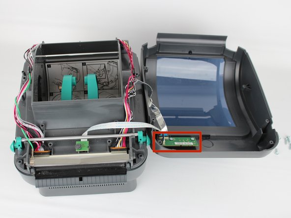

  • Put the lid back down and lay the top open as shown in the photo.
  • Be careful setting the lid down, as it could pull wiring from other components. If you need more wiggle room, you can remove the silver cable from the support clip on the side, as seen in the second photo by pulling the tab back and pushing the cable up.
  • The component we are replacing is on the underneath of the top of the device, highlighted in the photo
