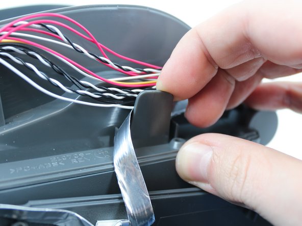

    3. Zebra ZP 450 Feed Key Replacement, Open Lid: crwdns2935265:03crwdnd2935265:01crwdnd2935265:02crwdne2935265:0 Zebra ZP 450 Feed Key Replacement, Open Lid: crwdns2935265:03crwdnd2935265:02crwdnd2935265:02crwdne2935265:0
      • Put the lid back down and lay the top open as shown in the photo.
      • Be careful setting the lid down, as it could pull wiring from other components. If you need more wiggle room, you can remove the silver cable from the support clip on the side, as seen in the second photo by pulling the tab back and pushing the cable up.
      • The component we are replacing is on the underneath of the top of the device, highlighted in the photo
    4. Zebra ZP 450 Feed Key Replacement, Remove No-Fuss Ribbon Cable Connectors: crwdns2935265:04crwdnd2935265:01crwdnd2935265:02crwdne2935265:0 Zebra ZP 450 Feed Key Replacement, Remove No-Fuss Ribbon Cable Connectors: crwdns2935265:04crwdnd2935265:02crwdnd2935265:02crwdne2935265:0
      • Starting with either ribbon cable, grip it on either side and gently pull out - The cable will come out of it's connector.
      • Repeat for other ribbon cable
      • Ribbons may be fragile, so handle with care.

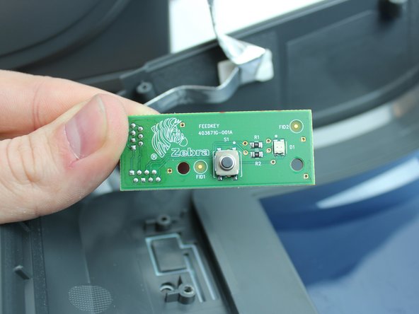

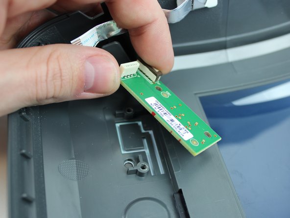

    5. Zebra ZP 450 Feed Key Replacement, Remove Circuit Board: crwdns2935265:05crwdnd2935265:01crwdnd2935265:03crwdne2935265:0 Zebra ZP 450 Feed Key Replacement, Remove Circuit Board: crwdns2935265:05crwdnd2935265:02crwdnd2935265:03crwdne2935265:0 Zebra ZP 450 Feed Key Replacement, Remove Circuit Board: crwdns2935265:05crwdnd2935265:03crwdnd2935265:03crwdne2935265:0
      • Remove 2 7.51mm Phillips screws holding the circuit board onto the device casing.
