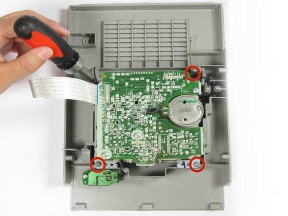

Panasonic SC-PM31 Cassette Player Replacement, Removing the circuit board: crwdns2935265:00crwdnd2935265:01crwdnd2935265:01crwdne2935265:0
  • Turn the top panel upside down.
  • Remove the four Phillips #2 dome-headed screws with length 9.5mm holding the cassette assembly to the plastic exterior.
