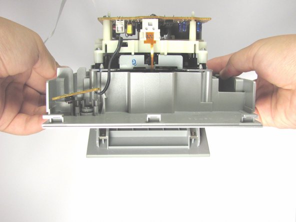

  5. Panasonic SC-PM31 Cassette Player Replacement, Removing the circuit board: crwdns2935265:05crwdnd2935265:01crwdnd2935265:01crwdne2935265:0
    • Turn the top panel upside down.
    • Remove the four Phillips #2 dome-headed screws with length 9.5mm holding the cassette assembly to the plastic exterior.

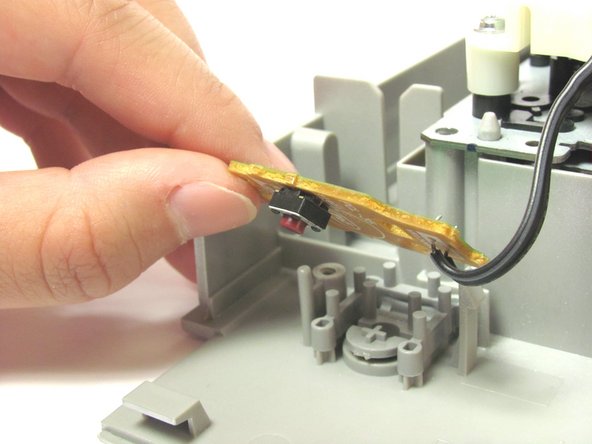

  6. Panasonic SC-PM31 Cassette Player Replacement, Removing the smaller circuit board: crwdns2935265:06crwdnd2935265:01crwdnd2935265:02crwdne2935265:0 Panasonic SC-PM31 Cassette Player Replacement, Removing the smaller circuit board: crwdns2935265:06crwdnd2935265:02crwdnd2935265:02crwdne2935265:0
    • Remove the Phillips #2 screw with length 9.5mm from the small circuit board.
    • Lift the small circuit board from the plastic.

  8. Panasonic SC-PM31 Cassette Player Replacement, Removing the cassette player: crwdns2935265:08crwdnd2935265:01crwdnd2935265:01crwdne2935265:0
    • Carefully lift the cassette player out of the plastic casing.
