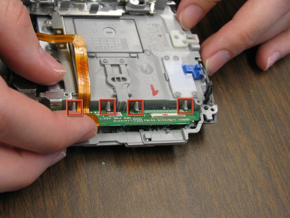

  • Reinsert the circuit board into the slot. Make sure to lock it securely under the tabs.
  • Reinsert the L-shaped metal piece into its slot. Line it up with the screw hole and the protruding place holder.
  • Reinsert the 2 screws in the circuit board with the longer screw holding the L-shaped metal piece in place.
