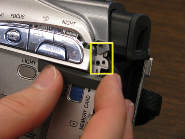

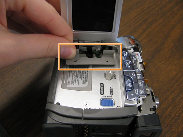

    • Note: Open the LCD screen for better access to remove the screw. Reclose the screen when finished.
    • Lift up the dark gray tab on the LCD side of the camera and move it aside.
    • Remove the screw under the dark gray tab and then replace the tab.
  4. JVC GR-D290U LCD Screen Replacement: crwdns2935265:04crwdnd2935265:01crwdnd2935265:02crwdne2935265:0 JVC GR-D290U LCD Screen Replacement: crwdns2935265:04crwdnd2935265:02crwdnd2935265:02crwdne2935265:0

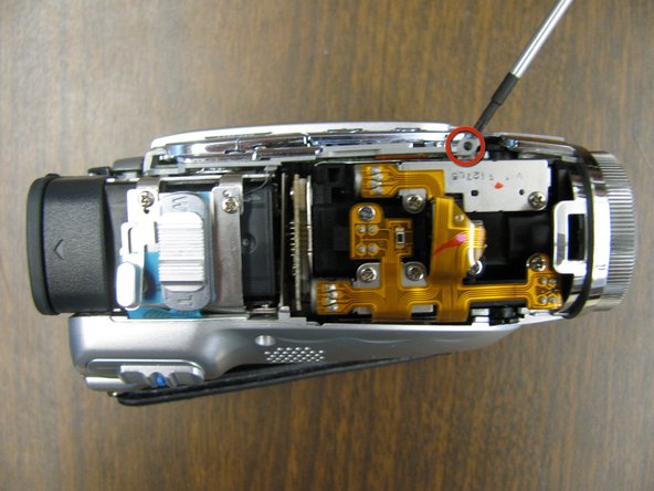

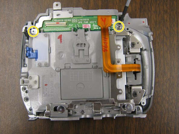

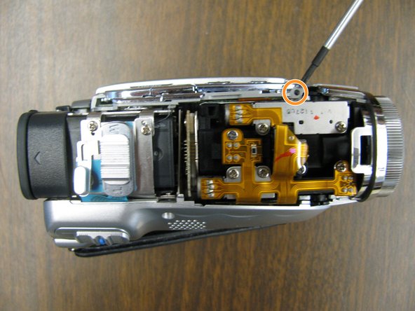

    • Remove the 2 screws underneath the top cover on the LCD side of the camera.

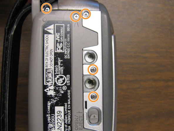

  6. JVC GR-D290U LCD Screen Replacement: crwdns2935265:06crwdnd2935265:01crwdnd2935265:01crwdne2935265:0
    • Remove the 5 screws indicated on the bottom plate of the camera.

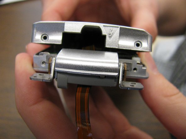

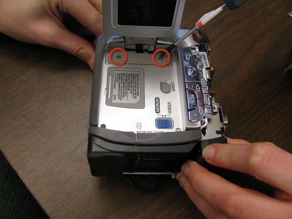

    • Open the LCD screen and remove the 2 screws at the hinge of the screen.
    • Remove the plastic hinge cover from the camera base.
    • Close the LCD screen when finished.

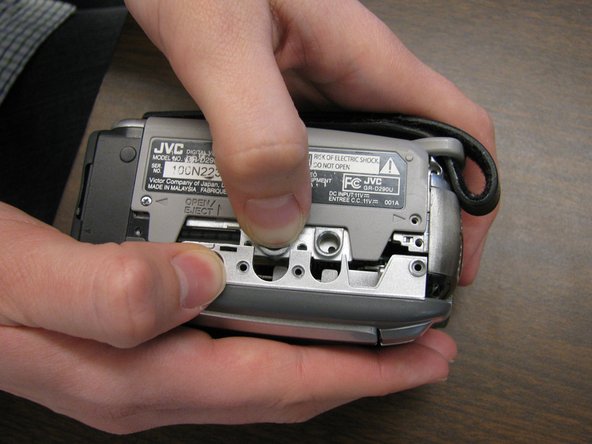

  8. JVC GR-D290U LCD Screen Replacement: crwdns2935265:08crwdnd2935265:01crwdnd2935265:02crwdne2935265:0 JVC GR-D290U LCD Screen Replacement: crwdns2935265:08crwdnd2935265:02crwdnd2935265:02crwdne2935265:0
    • Warning: Avoid detaching the internal wiring by prying the camera apart slowly and carefully.

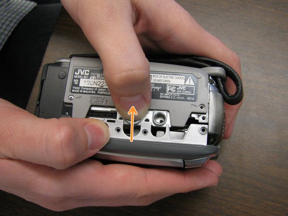

    • Start from the bottom of the camera. Press and hold the eject button with one hand.
    • Use your other hand to pry the LCD screen cover from the base. Leave the labeled side closed.
  9. JVC GR-D290U LCD Screen Replacement: crwdns2935265:09crwdnd2935265:01crwdnd2935265:03crwdne2935265:0 JVC GR-D290U LCD Screen Replacement: crwdns2935265:09crwdnd2935265:02crwdnd2935265:03crwdne2935265:0 JVC GR-D290U LCD Screen Replacement: crwdns2935265:09crwdnd2935265:03crwdnd2935265:03crwdne2935265:0

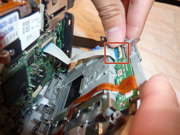

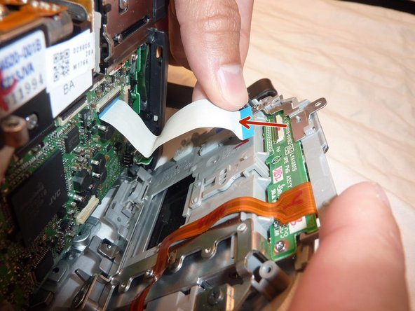

    • Detach the white tab from the LCD screen side of the camera by gently tugging at the base of the tab.
    • Put the larger camera base aside.

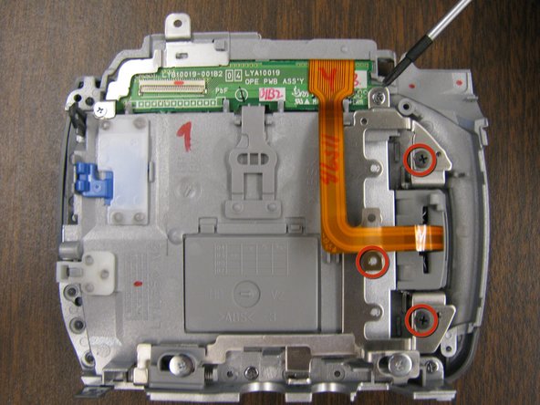

  10. JVC GR-D290U LCD Screen Replacement: crwdns2935265:010crwdnd2935265:01crwdnd2935265:01crwdne2935265:0

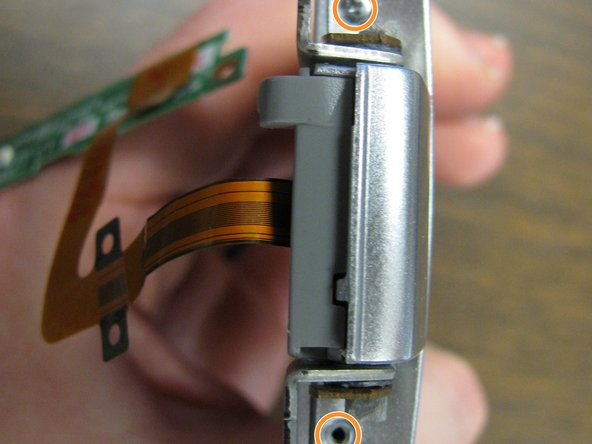

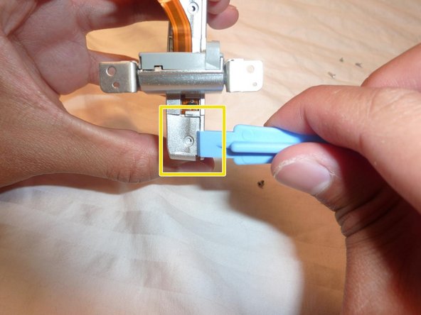

    • Remove the 3 screws holding the LCD screen hinge to the base.
  11. JVC GR-D290U LCD Screen Replacement: crwdns2935265:011crwdnd2935265:01crwdnd2935265:01crwdne2935265:0

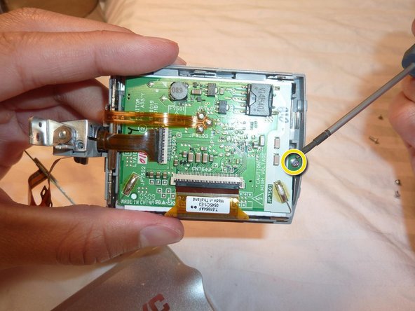

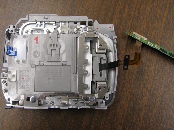

    • Remove the 2 screws on the green circuit board.
  12. JVC GR-D290U LCD Screen Replacement: crwdns2935265:012crwdnd2935265:01crwdnd2935265:03crwdne2935265:0 JVC GR-D290U LCD Screen Replacement: crwdns2935265:012crwdnd2935265:02crwdnd2935265:03crwdne2935265:0 JVC GR-D290U LCD Screen Replacement: crwdns2935265:012crwdnd2935265:03crwdnd2935265:03crwdne2935265:0

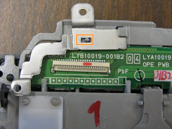

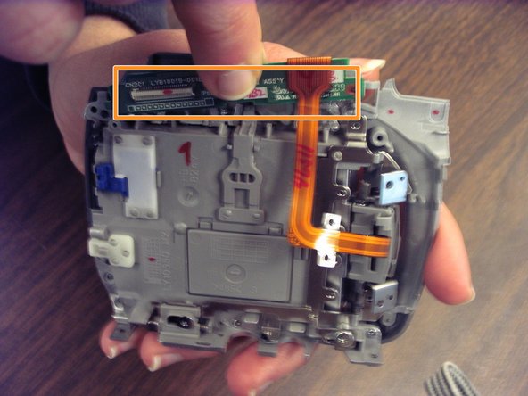

    • Warning: The orange band must stay attached to the circuit board at all times.
    • Remove the L-shaped metal piece from the upper left-hand corner of the circuit board.
    • Remove the circuit board from the cover piece and move it aside with the orange band intact.

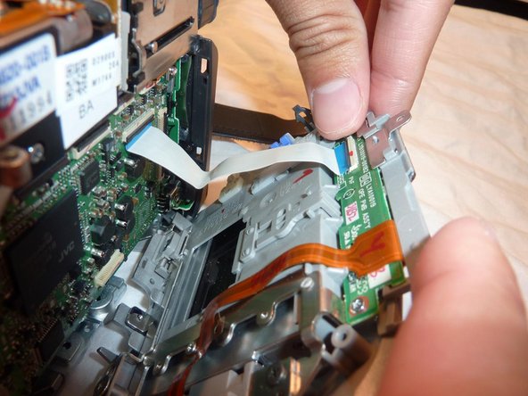

  13. JVC GR-D290U LCD Screen Replacement: crwdns2935265:013crwdnd2935265:01crwdnd2935265:03crwdne2935265:0 JVC GR-D290U LCD Screen Replacement: crwdns2935265:013crwdnd2935265:02crwdnd2935265:03crwdne2935265:0 JVC GR-D290U LCD Screen Replacement: crwdns2935265:013crwdnd2935265:03crwdnd2935265:03crwdne2935265:0

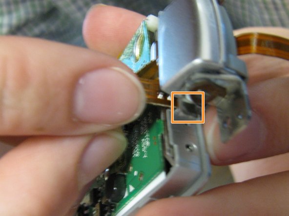

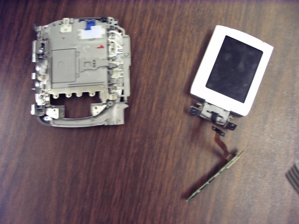

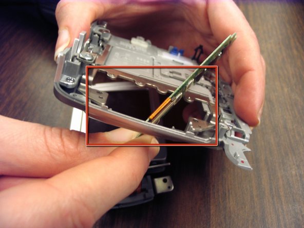

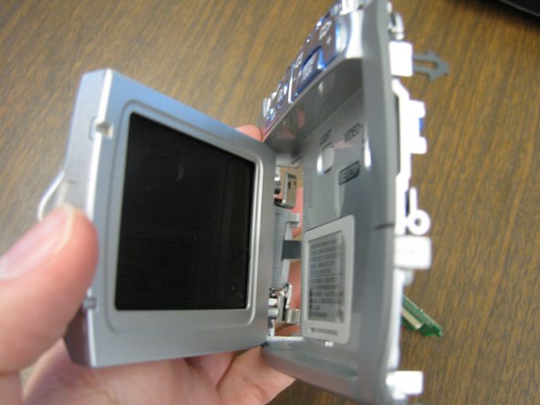

    • Open the LCD screen and carefully pull the circuit board through the empty hinge space.
    • Set aside the larger LCD panel.

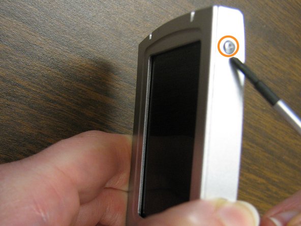

    • Remove the 2 screws on the hinge side of the LCD screen.
    • Remove the screw at side of the LCD screen.
    • Pull it open with a plastic opening tool and pry it apart.

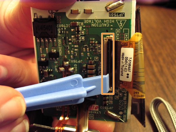

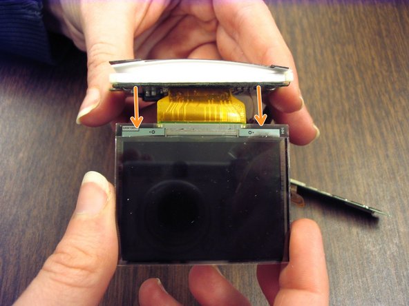

    • Remove the screw in the circuit board.
    • Pull the LCD screen pack from the frame with the circuit board on top.

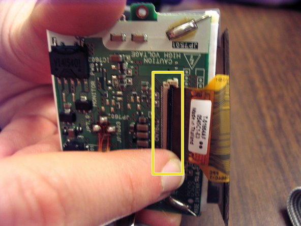

    • Detach the LCD screen by firmly grasping the copper tab and gently tugging until the latch unsnaps.
  16. JVC GR-D290U LCD Screen Replacement: crwdns2935265:016crwdnd2935265:01crwdnd2935265:02crwdne2935265:0 JVC GR-D290U LCD Screen Replacement: crwdns2935265:016crwdnd2935265:02crwdnd2935265:02crwdne2935265:0
    • Connect the new LCD screen by fitting in the copper attachment site to the thin, black clasp on the circuit board.
    • Fold over the black clasp and snap it into place.
    • Note: You may need to use the plastic opening tool to snap thin black clasp into place.

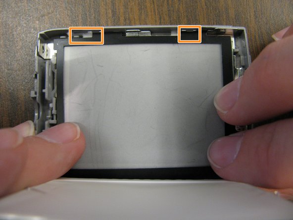

    • Put the LCD screen into the silver frame and make sure it lies flat. It should line up with the two white plastic brackets.
    • Place the black film frame lined up with the white film into the silver frame. Both should be held in place by tabs.

    • Before reattaching the LCD screen lid, make sure the silver hinge piece is inserted in the slot next to the circuit board.
    • Replace the loose orange band in the slot on the hinge side of the LCD screen.
    • Snap the LCD screen lid back in place starting at the side opposite the hinge.
