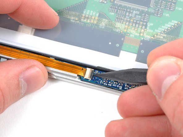

  • Use the tip of a spudger or your fingernail to flip up the ZIF retaining flap on the camera cable socket at the edge of the camera board near the top center of the front display bezel.
  • Be sure you are prying up on the retaining flap, not the socket itself.
  • Pull the camera cable out of its socket.
  • Peel the camera cable off the foam tape along the top edge of the display.
