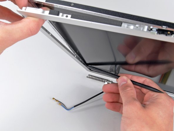

  20. MacBook Pro 17" Models A1151 A1212 A1229 and A1261 LCD Replacement: crwdns2935265:020crwdnd2935265:01crwdnd2935265:01crwdne2935265:0
    • Slightly lift the lower edge of the display and pull it away from the rear display bezel.
    • The rear display bezel remains.

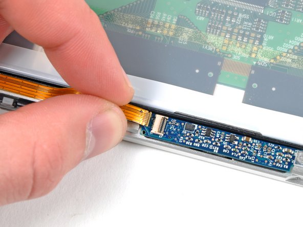

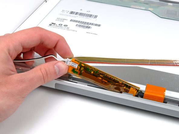

  21. MacBook Pro 17" Models A1151 A1212 A1229 and A1261 LCD Replacement, LCD: crwdns2935265:021crwdnd2935265:01crwdnd2935265:02crwdne2935265:0 MacBook Pro 17" Models A1151 A1212 A1229 and A1261 LCD Replacement, LCD: crwdns2935265:021crwdnd2935265:02crwdnd2935265:02crwdne2935265:0
    • Remove the strip of tape covering the backlight leads.
    • Carefully lift the inverter out of the clutch cover enough to reach the backlight connector.
  22. MacBook Pro 17" Models A1151 A1212 A1229 and A1261 LCD Replacement: crwdns2935265:022crwdnd2935265:01crwdnd2935265:01crwdne2935265:0
    • Disconnect the backlight cable from the inverter board.
  23. MacBook Pro 17" Models A1151 A1212 A1229 and A1261 LCD Replacement: crwdns2935265:023crwdnd2935265:01crwdnd2935265:01crwdne2935265:0

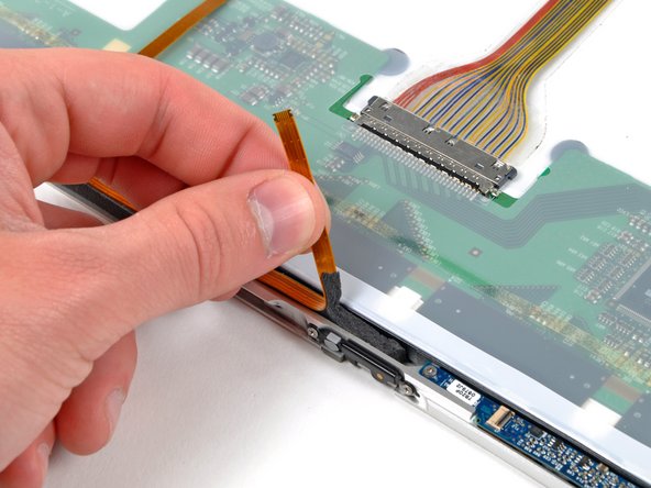

  25. MacBook Pro 17" Models A1151 A1212 A1229 and A1261 LCD Replacement: crwdns2935265:025crwdnd2935265:01crwdnd2935265:03crwdne2935265:0 MacBook Pro 17" Models A1151 A1212 A1229 and A1261 LCD Replacement: crwdns2935265:025crwdnd2935265:02crwdnd2935265:03crwdne2935265:0 MacBook Pro 17" Models A1151 A1212 A1229 and A1261 LCD Replacement: crwdns2935265:025crwdnd2935265:03crwdnd2935265:03crwdne2935265:0
    • Use the tip of a spudger or your fingernail to flip up the ZIF retaining flap on the camera cable socket at the edge of the camera board near the top center of the front display bezel.
    • Be sure you are prying up on the retaining flap, not the socket itself.
    • Pull the camera cable out of its socket.
    • Peel the camera cable off the foam tape along the top edge of the display.

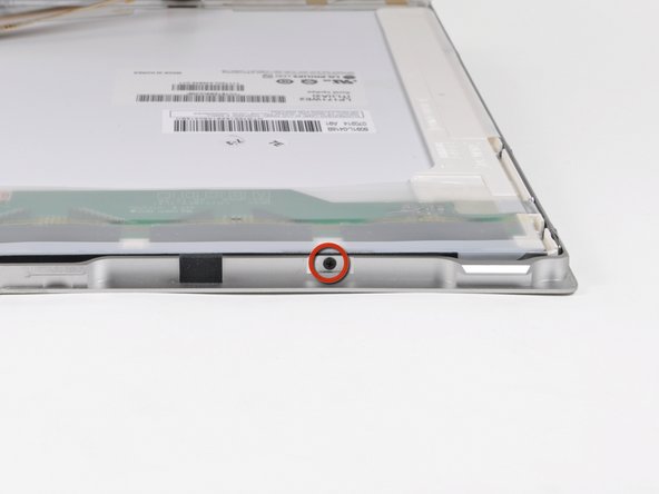

    • Remove the four 3.2 mm Phillips screws along the right edge of the display.
  28. MacBook Pro 17" Models A1151 A1212 A1229 and A1261 LCD Replacement: crwdns2935265:028crwdnd2935265:01crwdnd2935265:02crwdne2935265:0 MacBook Pro 17" Models A1151 A1212 A1229 and A1261 LCD Replacement: crwdns2935265:028crwdnd2935265:02crwdnd2935265:02crwdne2935265:0
    • Remove the two 3.2 mm Phillips screws on the top edge of the display.
  29. MacBook Pro 17" Models A1151 A1212 A1229 and A1261 LCD Replacement: crwdns2935265:029crwdnd2935265:01crwdnd2935265:01crwdne2935265:0
    • Remove the four 3.2 mm Phillips screws along the left edge of the display.
