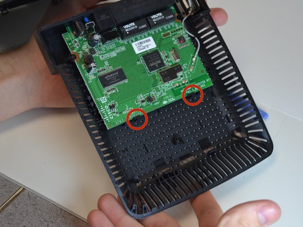

  • The cover can now be removed.
  • To repair anything on the circuit board, use the plastic opening tool to pull back on the two tabs holding it down.
  • Use caution when pulling on the tabs as they are stiff and easy to break.
  • Keep the tabs if they snap off. The tabs can be reattached with glue when reassembling the device.
