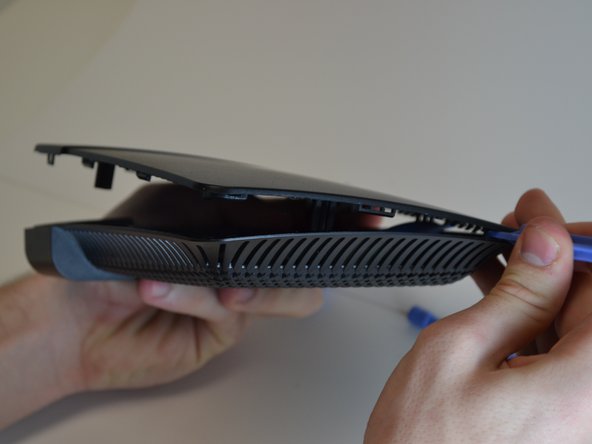

    2. Disassembling the Linksys E1200: crwdns2935265:02crwdnd2935265:01crwdnd2935265:03crwdne2935265:0 Disassembling the Linksys E1200: crwdns2935265:02crwdnd2935265:02crwdnd2935265:03crwdne2935265:0 Disassembling the Linksys E1200: crwdns2935265:02crwdnd2935265:03crwdnd2935265:03crwdne2935265:0
      • Once the three screws are removed, the device is ready for disassembly.
      • Push up on the rear flap while holding down on the rest of the body. This will open a small gap.
      • Insert the plastic opening tool in the gap and begin prying on the corner.
      • Continue to pry around the body of the case. Separate both sides of the case with this method.
    3. Disassembling the Linksys E1200: crwdns2935265:03crwdnd2935265:01crwdnd2935265:02crwdne2935265:0 Disassembling the Linksys E1200: crwdns2935265:03crwdnd2935265:02crwdnd2935265:02crwdne2935265:0
      • Once the sides are released, the front of the cover can be removed.
      • Use a plastic opening tool to separate the front of the cover from the body.
      • It is helpful to use a different plastic opening tool as a wedge on the sides to prevent them from snapping back together.

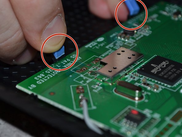

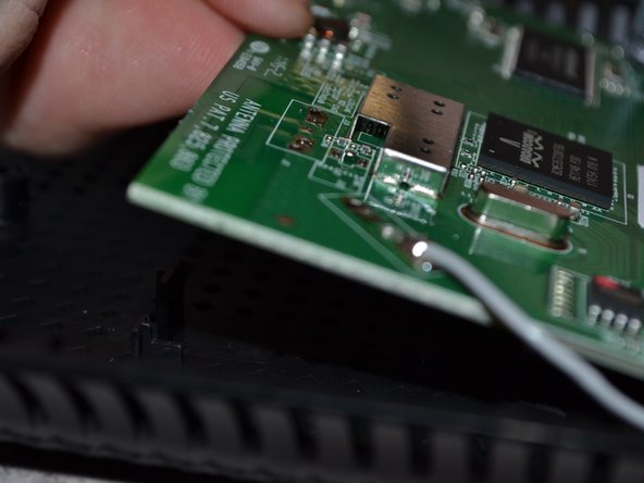

    4. Disassembling the Linksys E1200: crwdns2935265:04crwdnd2935265:01crwdnd2935265:03crwdne2935265:0 Disassembling the Linksys E1200: crwdns2935265:04crwdnd2935265:02crwdnd2935265:03crwdne2935265:0 Disassembling the Linksys E1200: crwdns2935265:04crwdnd2935265:03crwdnd2935265:03crwdne2935265:0
      • The cover can now be removed.
      • To repair anything on the circuit board, use the plastic opening tool to pull back on the two tabs holding it down.
      • Use caution when pulling on the tabs as they are stiff and easy to break.
      • Keep the tabs if they snap off. The tabs can be reattached with glue when reassembling the device.

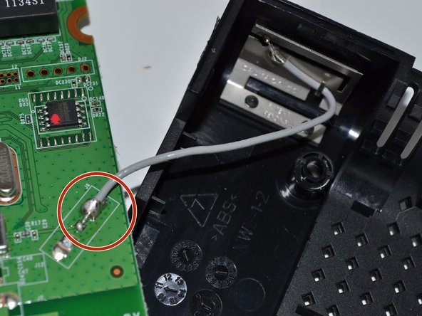

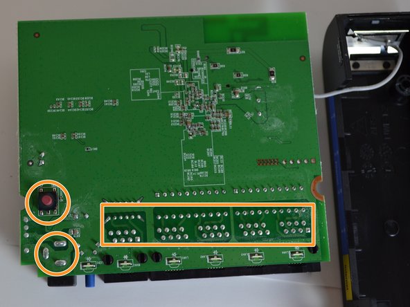

    5. Disassembling the Linksys E1200: crwdns2935265:05crwdnd2935265:01crwdnd2935265:03crwdne2935265:0 Disassembling the Linksys E1200: crwdns2935265:05crwdnd2935265:02crwdnd2935265:03crwdne2935265:0 Disassembling the Linksys E1200: crwdns2935265:05crwdnd2935265:03crwdnd2935265:03crwdne2935265:0
      • If the antenna needs to be disconnected, desolder the connection and reattach it prior to reassembly.
      • If the ethernet ports, power port, or reset button are damaged, the large solder points allow you to replace them.
      • Many components on the board cannot be serviced. These components were attached by a machine and cannot be removed.
