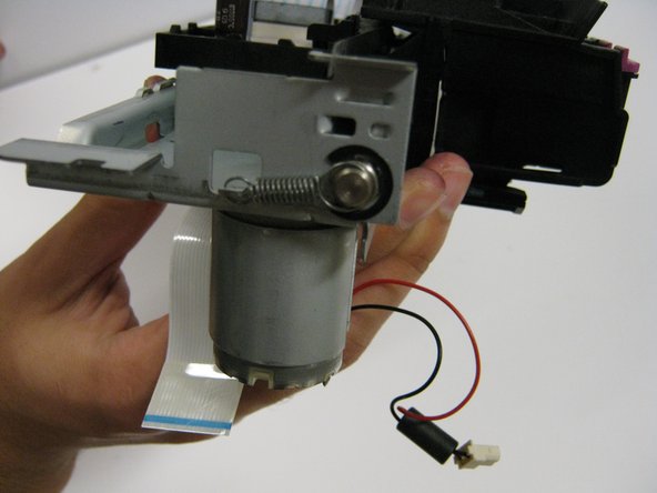

  • Locate the springs. They will be on the side of the metal frame.
  • Using the tweezers, grab the loop of the spring that is connected to the bar.
  • Remove the spring by lifting the loop.
