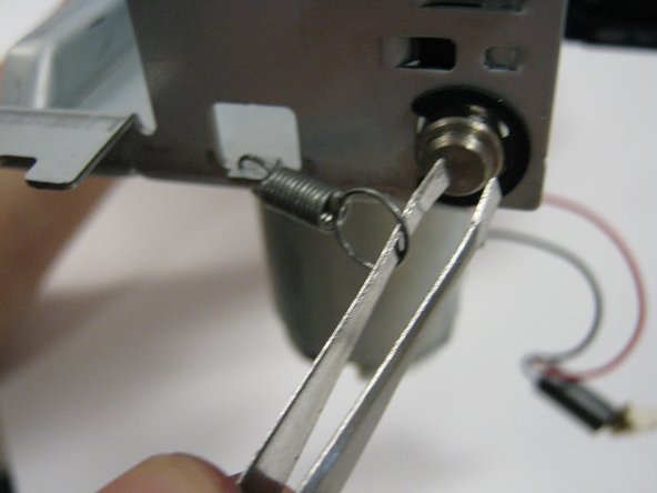

    • Locate the springs. They will be on the side of the metal frame.
    • Using the tweezers, grab the loop of the spring that is connected to the bar.
    • Remove the spring by lifting the loop.
