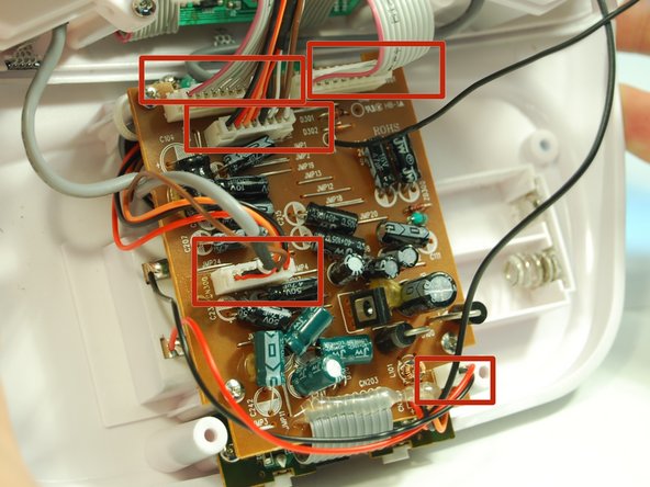

  • Pull out the 5 white pinhead connectors using an IC (Integrated Circuit) extractor. Pinch the IC extractor just under the top lip of the wire housing.
  • There are two 10 pin connectors, one 8 pin connector, one 7 pin connector, and one 2 pin connector.
  • When reassembling, there is only one way to reinsert the pinhead connectors. Make sure the orientation matches that of the receiving connector on the motherboard.
