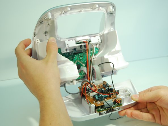

  12. Memorex Mi3X Minimove Battery Wire Replacement, Battery Pack Wire: crwdns2935265:012crwdnd2935265:01crwdnd2935265:02crwdne2935265:0 Memorex Mi3X Minimove Battery Wire Replacement, Battery Pack Wire: crwdns2935265:012crwdnd2935265:02crwdnd2935265:02crwdne2935265:0
    • Be careful when removing the bottom panel. The plastic tab that runs alongside the right speaker between the upper brown radio motherboard and the lower green audio daughterboard may damage the device if the bottom panel is improperly removed.
    • Remove the bottom panel of the boombox by carefully pulling the panel straight backwards from the boombox until the motherboard and daughterboard are free.

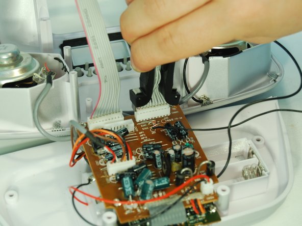

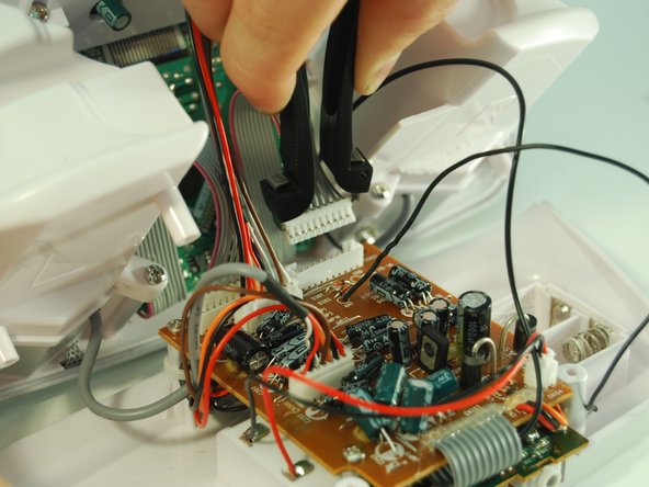

  13. Memorex Mi3X Minimove Battery Wire Replacement: crwdns2935265:013crwdnd2935265:01crwdnd2935265:03crwdne2935265:0 Memorex Mi3X Minimove Battery Wire Replacement: crwdns2935265:013crwdnd2935265:02crwdnd2935265:03crwdne2935265:0 Memorex Mi3X Minimove Battery Wire Replacement: crwdns2935265:013crwdnd2935265:03crwdnd2935265:03crwdne2935265:0
    • Pull out the 5 white pinhead connectors using an IC (Integrated Circuit) extractor. Pinch the IC extractor just under the top lip of the wire housing.
    • There are two 10 pin connectors, one 8 pin connector, one 7 pin connector, and one 2 pin connector.
    • When reassembling, there is only one way to reinsert the pinhead connectors. Make sure the orientation matches that of the receiving connector on the motherboard.
