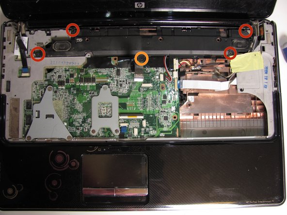

  • Using the Phillips #1 screwdriver, remove the four Phillips 4mm screws that secure the speaker assembly.
  • You will also need the Phillips #1 screwdriver to remove the Phillips 7mm screw that secures the center of the speaker assembly.
  • Remove the speaker assembly from the computer.
