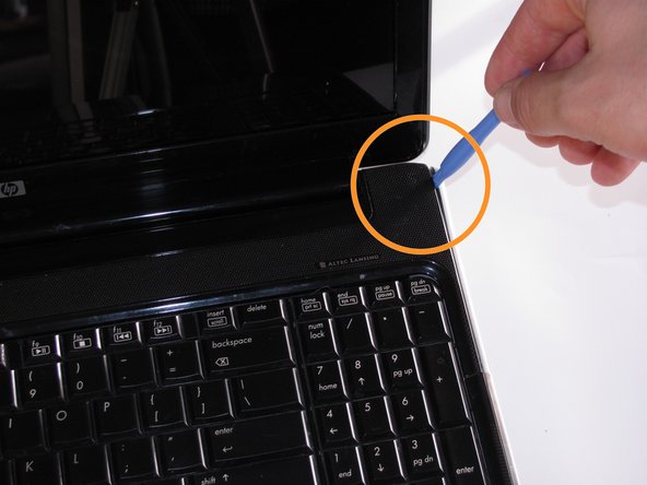

    • Turn the computer over, and locate the Switch Cover.
    • Using the Safe Pry Tool, un-clip the Switch Cover until it detaches from the computer.
    • The clips will need careful prying to unhook.
  8. HP Pavilion dv6-2158nr Speaker Assembly Replacement: crwdns2935265:08crwdnd2935265:01crwdnd2935265:03crwdne2935265:0 HP Pavilion dv6-2158nr Speaker Assembly Replacement: crwdns2935265:08crwdnd2935265:02crwdnd2935265:03crwdne2935265:0 HP Pavilion dv6-2158nr Speaker Assembly Replacement: crwdns2935265:08crwdnd2935265:03crwdnd2935265:03crwdne2935265:0

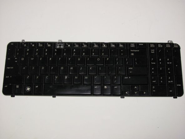

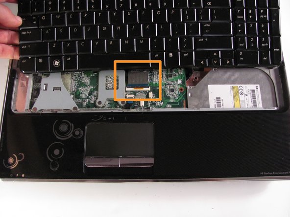

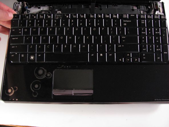

    • Remove the three silver Phillips 3.5mm screws that secure the keyboard to the computer.
    • Lift the rear edge of the keyboard and slide the keyboard back until the keyboard connector on the system board is accessible.
  10. HP Pavilion dv6-2158nr Speaker Assembly Replacement: crwdns2935265:010crwdnd2935265:01crwdnd2935265:03crwdne2935265:0 HP Pavilion dv6-2158nr Speaker Assembly Replacement: crwdns2935265:010crwdnd2935265:02crwdnd2935265:03crwdne2935265:0 HP Pavilion dv6-2158nr Speaker Assembly Replacement: crwdns2935265:010crwdnd2935265:03crwdnd2935265:03crwdne2935265:0
    • Unhinge the zero insertion force (ZIF) connector to release the ribbon cable then pull gently on the cable to release.
    • You need to unhinge the blue plastic to release the ribbon cable from the main board.
    • The keyboard can now be lifted off and set aside.

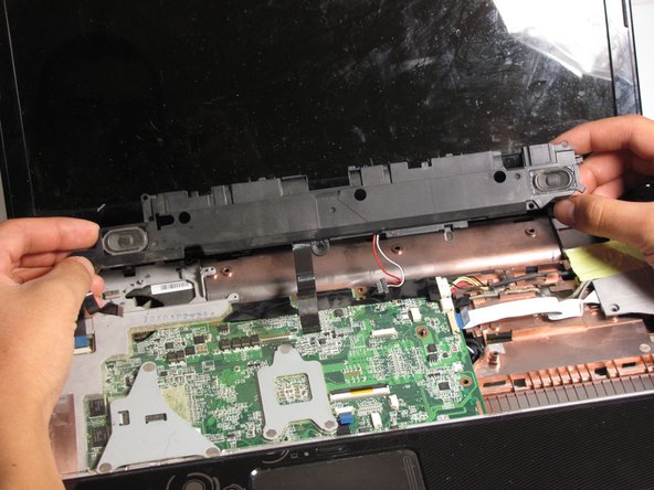

  11. HP Pavilion dv6-2158nr Speaker Assembly Replacement, Speaker Assembly: crwdns2935265:011crwdnd2935265:01crwdnd2935265:02crwdne2935265:0 HP Pavilion dv6-2158nr Speaker Assembly Replacement, Speaker Assembly: crwdns2935265:011crwdnd2935265:02crwdnd2935265:02crwdne2935265:0
    • Position the computer with the keyboard facing up its front edge toward you.
    • Disconnect the speaker cable from the system board.
  12. HP Pavilion dv6-2158nr Speaker Assembly Replacement: crwdns2935265:012crwdnd2935265:01crwdnd2935265:02crwdne2935265:0 HP Pavilion dv6-2158nr Speaker Assembly Replacement: crwdns2935265:012crwdnd2935265:02crwdnd2935265:02crwdne2935265:0
    • Using the Phillips #1 screwdriver, remove the four Phillips 4mm screws that secure the speaker assembly.
    • You will also need the Phillips #1 screwdriver to remove the Phillips 7mm screw that secures the center of the speaker assembly.
    • Remove the speaker assembly from the computer.
