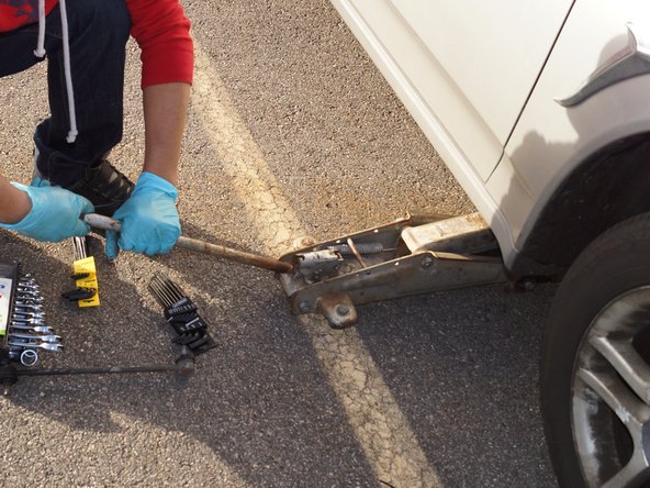

  • Place the hydraulic jack back under the car and lift it off the cinder blocks or jack stands.
  • Remove the cinder blocks or jack stands and lower the car back to the ground.
  • Further tighten the lug nuts using the torque wrench.
  • Tighten each nut with a torque wrench to a torque of 80ft/lb. See third picture for pattern to ensure proper tire alignment.
