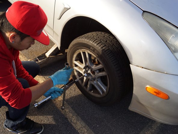

  • Put the tire back on and tighten the lug nuts using the lug wrench.
  • Only tighten tire until there is enough resistance to keep the tire attached to the wheel hub, with the following pattern to ensure proper tire alignment.
