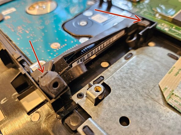

Remove drive
  • Carefully lift up a rubber blocks; the rubber may be old and where it attaches is thinner. This will give you room to slide the drive.
  • Insert a flathead screwdriver in the gap and slide the drive away from the connector. Do this on both sides.
