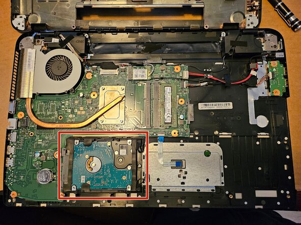

Locate drive
  • The drive uses a SATA connector.
  • The drive is kept in place by rubber. There are no screws.
  • The purple box shows the location of the two RAM slots. DDR3L 1600MHz. Maximum of 16 GB.
