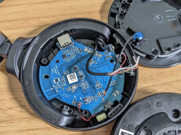

Re-seat the ear cup holder onto the earcup and re-solder the cable
  • Re-seat the ear cup holder onto the earcup, making sure you pass the cable through.
  • Re-solder the cables in place, making sure you keep the original order.
  • Once done, re-add the screw, as well as the led cover.
