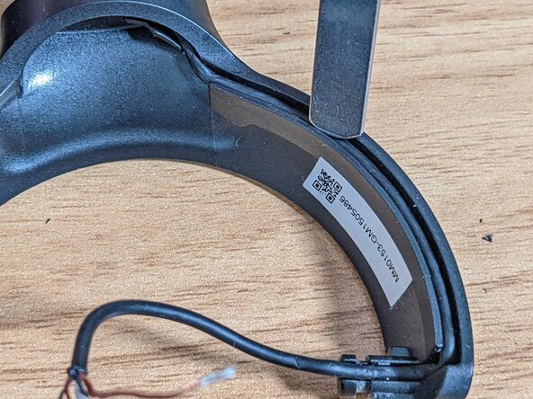

JBL Tune 510BT Ear cup holder replacement, Set the cable back into its channel: crwdns2935265:00crwdnd2935265:01crwdnd2935265:01crwdne2935265:0
  • Use the spatula to set the cable back into its channel. It should hold the cable tighly and ensure it does not move around.
  • Do not press too hard or you will kink the cable and might damage it. A gentle push works.
