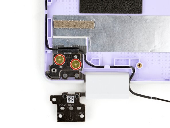

Framework Laptop 12 Hinge (Both) Installation

  • Use your Framework Screwdriver to install the four 2.5 mm‑long T5 Torx screws to secure the two hinges to the Top Cover.
  • Make sure to install these screws in the marked locations. There are additional screw holes on the hinges that are not for these screws.
