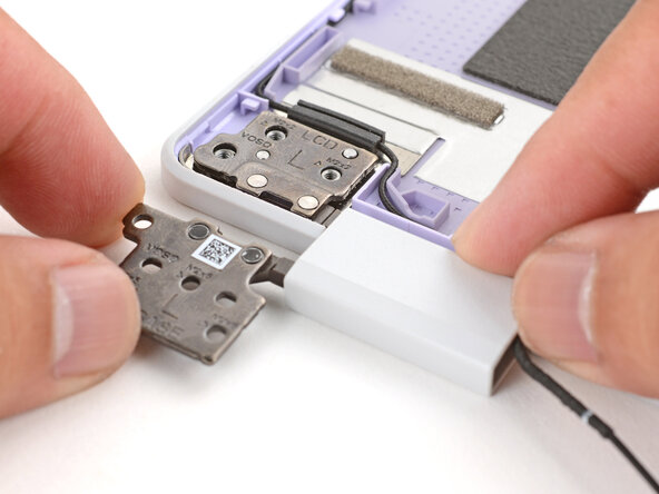

  1. Framework Laptop 12 Hinge (Both) Installation, Install the hinges: crwdns2935265:01crwdnd2935265:01crwdnd2935265:03crwdne2935265:0 Framework Laptop 12 Hinge (Both) Installation, Install the hinges: crwdns2935265:01crwdnd2935265:02crwdnd2935265:03crwdne2935265:0 Framework Laptop 12 Hinge (Both) Installation, Install the hinges: crwdns2935265:01crwdnd2935265:03crwdnd2935265:03crwdne2935265:0
    • Lay both hinges in place in the Top Cover.
    • Use the alignment pins to help position each hinge in place.

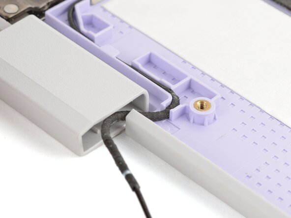

  2. Framework Laptop 12 Hinge (Both) Installation: crwdns2935265:02crwdnd2935265:01crwdnd2935265:02crwdne2935265:0 Framework Laptop 12 Hinge (Both) Installation: crwdns2935265:02crwdnd2935265:02crwdnd2935265:02crwdne2935265:0
    • Make sure both antenna cables are properly routed in the Top Cover and tucked into the hinges, as shown in the images.

    • Use your Framework Screwdriver to install the four 2.5 mm‑long T5 Torx screws to secure the two hinges to the Top Cover.
    • Make sure to install these screws in the marked locations. There are additional screw holes on the hinges that are not for these screws.
