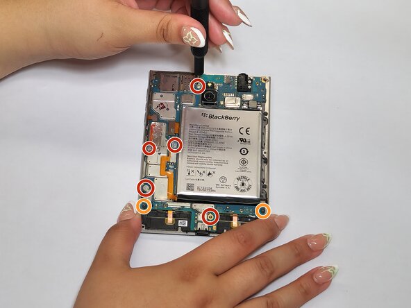

  • Remove the five 4 mm screws using a T4 Torx screwdriver.
  • Remove the two 3 mm screws using a T4 Torx screwdriver.
