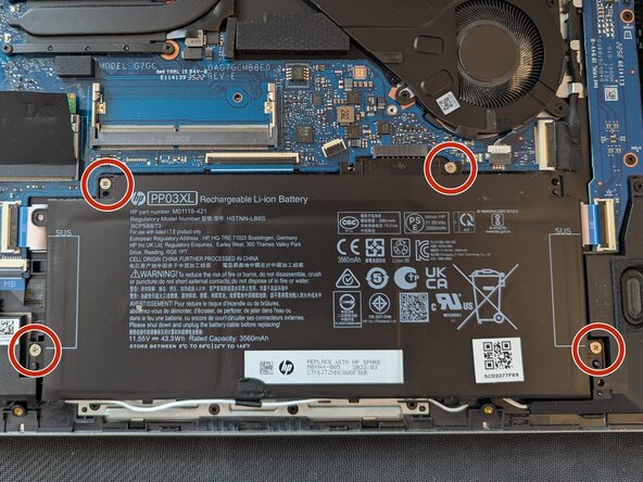

Disconnecting the battery
  • Unscrew the battery locking screws with a small Phillips head driver and save the screws (x4).
  • Unclip the thin white speaker cable that runs down the bottom edge of the battery cell.
  • Gently pry underneath the battery with plastic spudgers to lift the battery out of it's housing, which will also disconnect the battery from the system.
  • NOTE: There may still be charge left in the capacitors so wait a few minutes if you plan to tear down the device any further. Also, do not bend the battery at all, otherwise you will compromise it's integrity and could damage/brick your battery and/or device.
