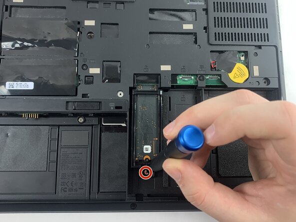

  • Remove the 4.4 mm Phillips #00 screw securing the SSD.
