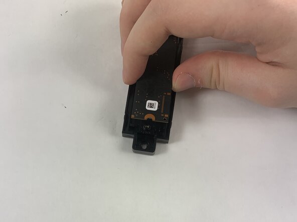

  6. Lenovo ThinkPad P50 SSD Replacement: crwdns2935265:06crwdnd2935265:01crwdnd2935265:02crwdne2935265:0 Lenovo ThinkPad P50 SSD Replacement: crwdns2935265:06crwdnd2935265:02crwdnd2935265:02crwdne2935265:0
    • Remove the 3.7 mm screw securing the SSD to the harness with a Phillips #00 screwdriver.

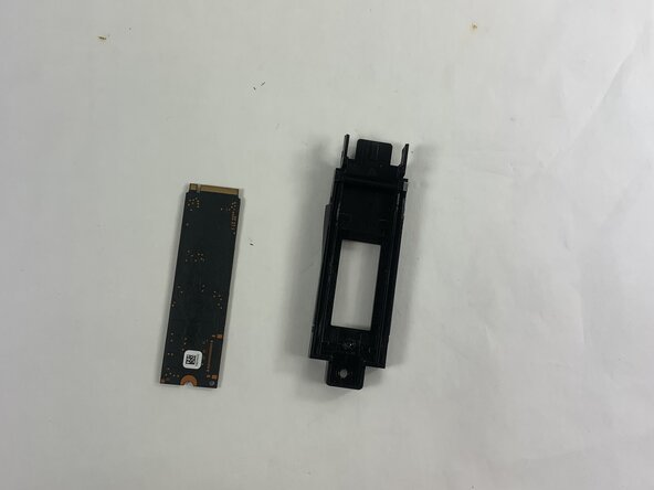

  7. Lenovo ThinkPad P50 SSD Replacement: crwdns2935265:07crwdnd2935265:01crwdnd2935265:02crwdne2935265:0 Lenovo ThinkPad P50 SSD Replacement: crwdns2935265:07crwdnd2935265:02crwdnd2935265:02crwdne2935265:0
    • Lift the drive up at about a 35 degree angle and pull out to remove it from the case.
