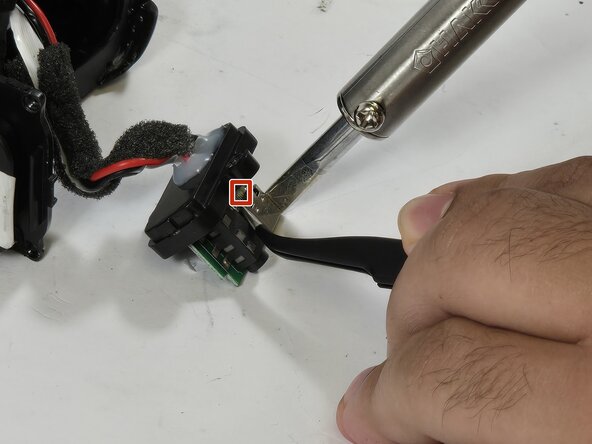

  • Press the soldering iron tip firmly to melt the solder.
  • If you heat the area for more than 10 seconds, the excessive heat may damage the board, port, and wires.
  • Use tweezers to remove the charging port.
