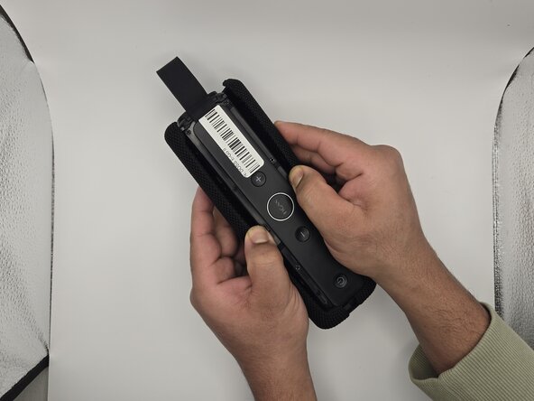

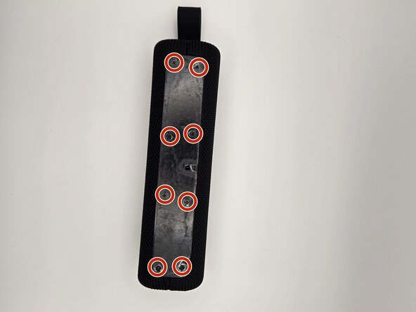

    • Peel the backing off of the speaker.
    • Remove eight 7.9 mm screws using the Phillips #00 screwdriver.
    • Gently pull apart the grille on the sides of the speaker.

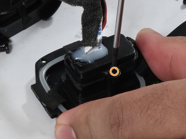

    • Remove four 7.8 mm screws using the Phillips #00 screwdriver.
    • Pull out the charging port and remove the two 7.8 mm screws using the Phillips #00 screwdriver.
    • Apply a bead of flux.

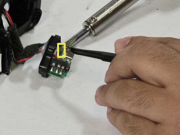

    • Press the soldering iron tip firmly to melt the solder.
    • If you heat the area for more than 10 seconds, the excessive heat may damage the board, port, and wires.
    • Use tweezers to remove the charging port.
