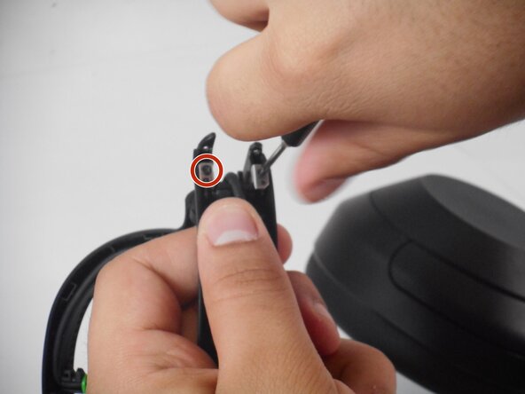

  • On the bottom plastic casing remove the two 3.5 mm Phillips screws attached at the metallic hinge.
  • Move the headphone wire out of the way.
  • Under the headphone wire there is a third screw on the metallic hinge. Remove this screw to remove the hinge.
