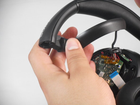

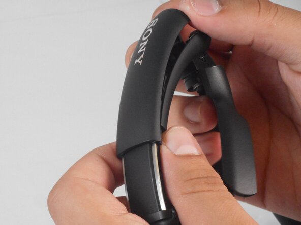

    • Fold the effected hinge's headphone cans inward to reveal four screws.
    • Remove the four screws using a Phillips #00 screwdriver.
    • There are two 4.3 mm screws on the bottom of the headband and two 3.5 mm screws on the sides of the hinge.

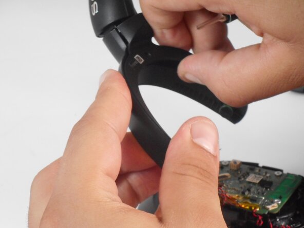

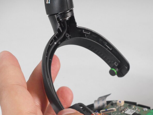

  2. Sony ULT WEAR Hinges Replacement: crwdns2935265:02crwdnd2935265:01crwdnd2935265:03crwdne2935265:0 Sony ULT WEAR Hinges Replacement: crwdns2935265:02crwdnd2935265:02crwdnd2935265:03crwdne2935265:0 Sony ULT WEAR Hinges Replacement: crwdns2935265:02crwdnd2935265:03crwdnd2935265:03crwdne2935265:0
    • Remove plastic casing between the screws to reveal metallic hinge and top of wire.
    • Lift and slide the top headband casing off.
    • Lift and slide bottom headband casing to reveal the rest of the wire and hinge.

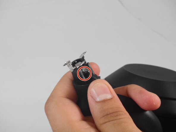

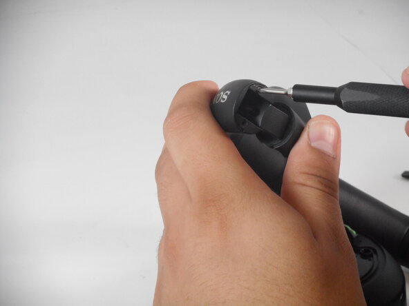

  3. Sony ULT WEAR Hinges Replacement: crwdns2935265:03crwdnd2935265:01crwdnd2935265:03crwdne2935265:0 Sony ULT WEAR Hinges Replacement: crwdns2935265:03crwdnd2935265:02crwdnd2935265:03crwdne2935265:0 Sony ULT WEAR Hinges Replacement: crwdns2935265:03crwdnd2935265:03crwdnd2935265:03crwdne2935265:0
    • On the bottom plastic casing remove the two 3.5 mm Phillips screws attached at the metallic hinge.
    • Move the headphone wire out of the way.
    • Under the headphone wire there is a third screw on the metallic hinge. Remove this screw to remove the hinge.

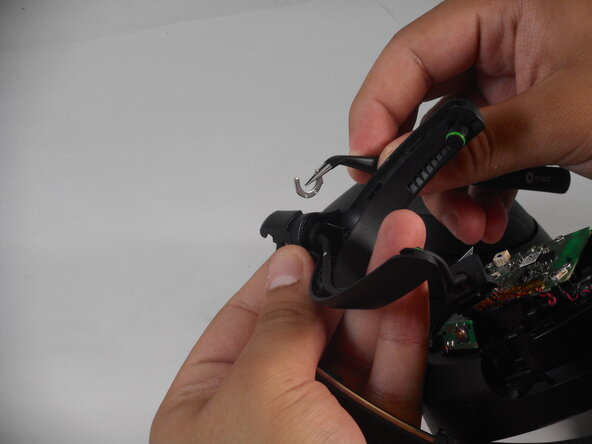

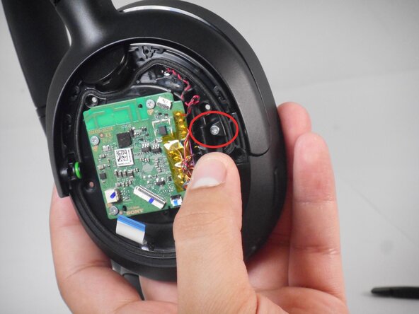

  4. Sony ULT WEAR Hinges Replacement: crwdns2935265:04crwdnd2935265:01crwdnd2935265:02crwdne2935265:0 Sony ULT WEAR Hinges Replacement: crwdns2935265:04crwdnd2935265:02crwdnd2935265:02crwdne2935265:0
    • There are three 0.5 mm screws holding the hinge. Two of them are located on the exterior and one is underneath the speaker wire.
    • Remove the screw under the speaker wire to remove the can hinge.

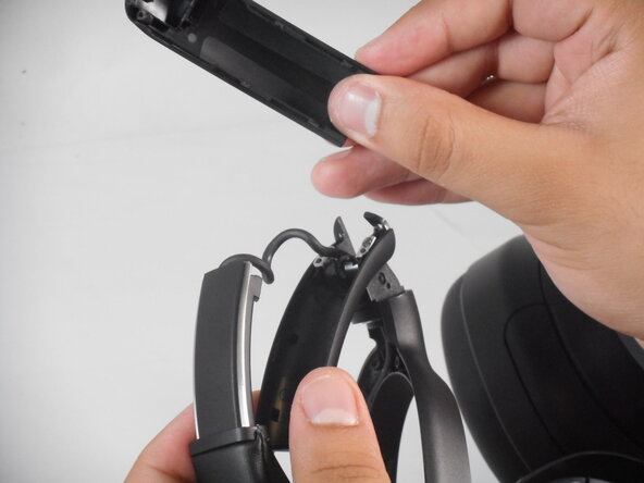

  5. Sony ULT WEAR Hinges Replacement: crwdns2935265:05crwdnd2935265:01crwdnd2935265:03crwdne2935265:0 Sony ULT WEAR Hinges Replacement: crwdns2935265:05crwdnd2935265:02crwdnd2935265:03crwdne2935265:0 Sony ULT WEAR Hinges Replacement: crwdns2935265:05crwdnd2935265:03crwdnd2935265:03crwdne2935265:0

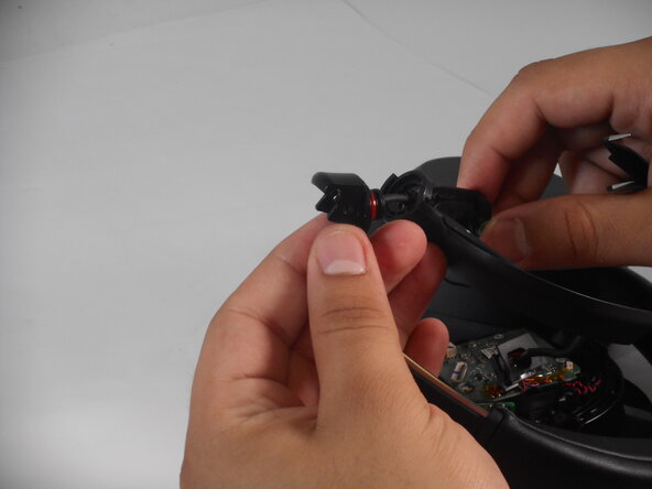

    • After removing the screws, there is another 3.5 mm screw on the actual hinge piece that must be removed.
    • Remove the plastic shell.

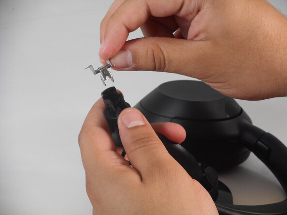

  6. Sony ULT WEAR Hinges Replacement: crwdns2935265:06crwdnd2935265:01crwdnd2935265:03crwdne2935265:0 Sony ULT WEAR Hinges Replacement: crwdns2935265:06crwdnd2935265:02crwdnd2935265:03crwdne2935265:0 Sony ULT WEAR Hinges Replacement: crwdns2935265:06crwdnd2935265:03crwdnd2935265:03crwdne2935265:0
    • Right under the inner part of the hinge, there is a small metal wedge holding the hinge in place. Remove this piece.
