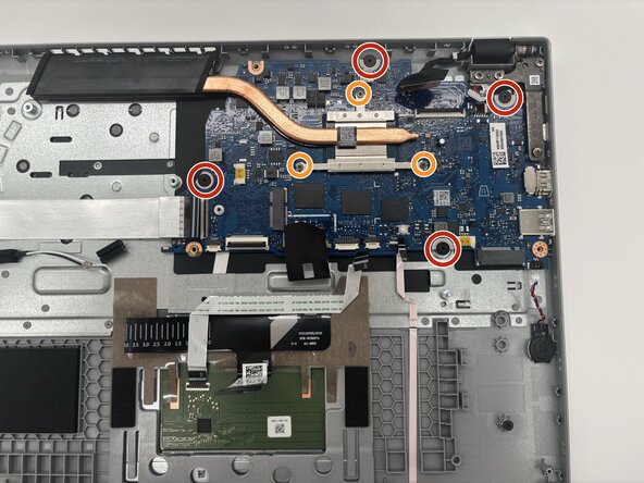

  • Use a Phillips #1 screwdriver to remove the four screws securing the motherboard to the chassis.
  • If your replacement board does not come with a heat sink, remove the three screws in descending order of the inscribed numbers on the heat sink.
  • If you aren't replacing the heat sink, loosen the screws before removing the motherboard.
  • Lift the motherboard from the laptop.
