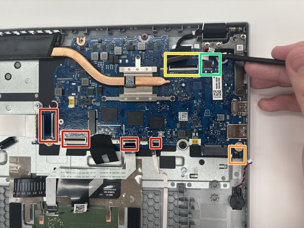

  • Use a spudger or a clean fingernail to flip up the locking flap on the four ZIF connectors—this is the unlocked position.
  • Use tweezers or your fingers to gently pull each cable out of its socket.
  • Try pushing on alternating sides of the CMOS battery connector with a spudger to disconnect it from the socket.
  • If that doesn't work, use a pair of tweezers to firmly grip the sides of the connector and pull straight away from the socket. Hold the tweezers closer to the connector to get a better grip.
  • To disconnect the display connector, first, gently push the tip of a spudger under the metal buckle to unclip it, then swing it over the socket.
  • Next, hold the buckle and cable together and gently pull the connector straight out of its socket.
  • Use the point of a spudger to push on alternating sides of the power connector to "walk" it out of its socket.
  • Don't pull on the wires or you risk damaging the connector and device.
