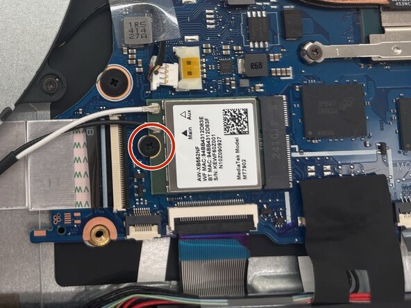

  • Use a Phillips #1 screwdriver to remove the 2 mm screw securing the Wi-Fi card to the motherboard.
  • Slide the Wi-Fi card out from the socket.
