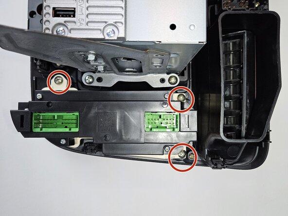

  • Use a Phillips #2 screwdriver to remove three 17 mm screws securing the climate control module to the head unit.
  • Remove the climate control module.
