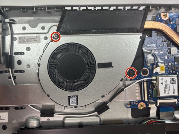

  • Use a Phillips #1 screwdriver to remove the two 3 mm screws attaching the fan to the chassis.
  • Slide the fan out from the socket to remove it.
