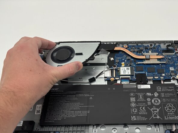

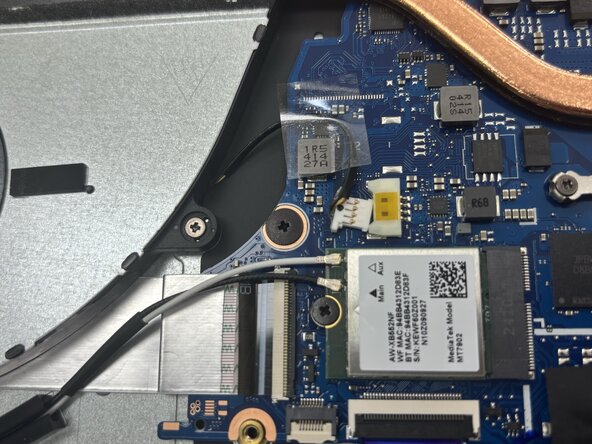

    • Use the end of a spudger to push on alternating sides of the sliding connector and remove it from the socket on the motherboard.
  4. Acer Aspire Go 15 AG15-31P-3947 Fan Replacement: crwdns2935265:04crwdnd2935265:01crwdnd2935265:03crwdne2935265:0 Acer Aspire Go 15 AG15-31P-3947 Fan Replacement: crwdns2935265:04crwdnd2935265:02crwdnd2935265:03crwdne2935265:0 Acer Aspire Go 15 AG15-31P-3947 Fan Replacement: crwdns2935265:04crwdnd2935265:03crwdnd2935265:03crwdne2935265:0

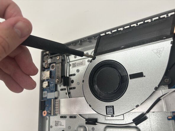

    • Use a Phillips #1 screwdriver to remove the two 3 mm screws attaching the fan to the chassis.
    • Slide the fan out from the socket to remove it.
