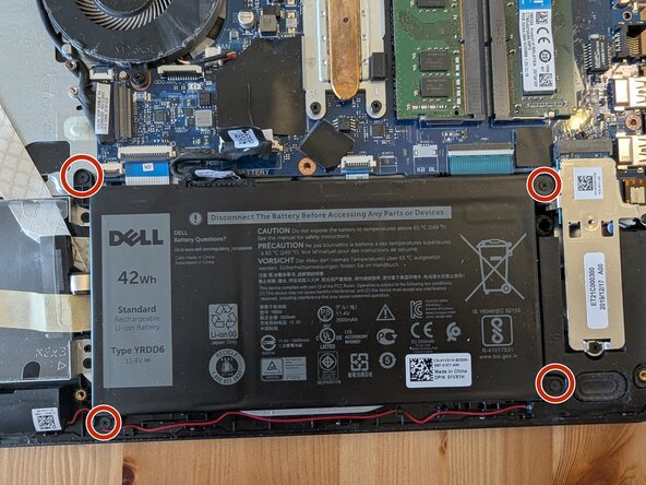

  • Remove four screws holding the battery in place.
  • Lift and remove the battery.
  • If the motherboard has a build-up of dust, clean it using compressed air.
  • Ensure that you blow the dust out of the laptop, not just move it around inside (angle the direction correctly).
