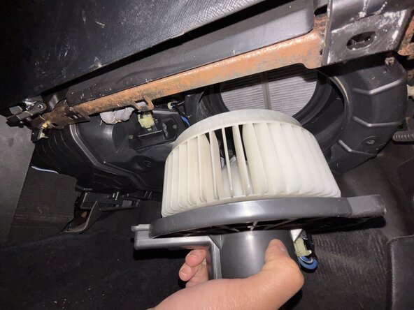

  • Set the new blower motor back into its housing.
  • Reconnect the wiring harness clip.
  • If you twisted it clockwise to remove it, make sure to twist it counter-clockwise to resecure it in the housing.
