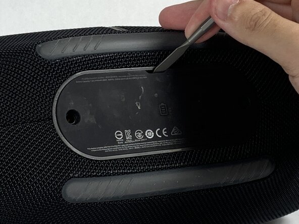

  • Insert a metal spudger into the designated notch.
  • Carefully pry off the casing and set it aside.
  • To avoid damaging the watertight seal, keep the pry bar in the notch only.
