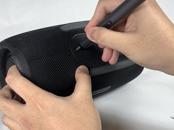

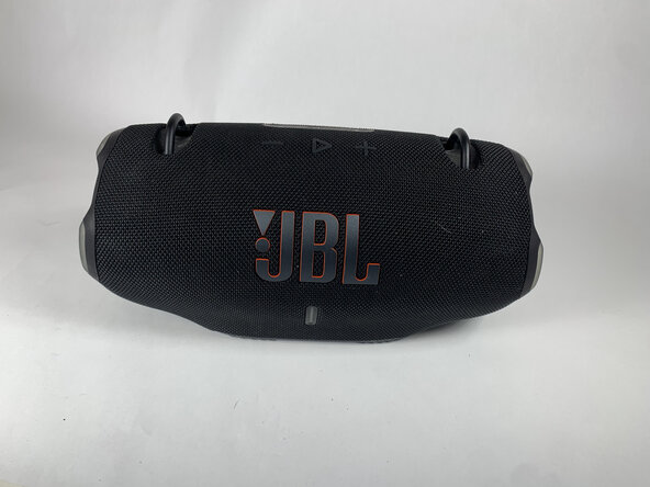

    • Flip the speaker to its base and locate the battery covering.
  2. JBL Xtreme 4 Battery Replacement: crwdns2935265:02crwdnd2935265:01crwdnd2935265:02crwdne2935265:0 JBL Xtreme 4 Battery Replacement: crwdns2935265:02crwdnd2935265:02crwdnd2935265:02crwdne2935265:0
    • Use the Torx head screwdriver to remove both screws and set them aside.
  3. JBL Xtreme 4 Battery Replacement: crwdns2935265:03crwdnd2935265:01crwdnd2935265:03crwdne2935265:0 JBL Xtreme 4 Battery Replacement: crwdns2935265:03crwdnd2935265:02crwdnd2935265:03crwdne2935265:0 JBL Xtreme 4 Battery Replacement: crwdns2935265:03crwdnd2935265:03crwdnd2935265:03crwdne2935265:0
    • Insert a metal spudger into the designated notch.
    • Carefully pry off the casing and set it aside.
    • To avoid damaging the watertight seal, keep the pry bar in the notch only.
  4. JBL Xtreme 4 Battery Replacement: crwdns2935265:04crwdnd2935265:01crwdnd2935265:03crwdne2935265:0 JBL Xtreme 4 Battery Replacement: crwdns2935265:04crwdnd2935265:02crwdnd2935265:03crwdne2935265:0 JBL Xtreme 4 Battery Replacement: crwdns2935265:04crwdnd2935265:03crwdnd2935265:03crwdne2935265:0
    • Remove the battery from the casing by firmly pulling the orange tab.
  5. JBL Xtreme 4 Battery Replacement: crwdns2935265:05crwdnd2935265:01crwdnd2935265:03crwdne2935265:0 JBL Xtreme 4 Battery Replacement: crwdns2935265:05crwdnd2935265:02crwdnd2935265:03crwdne2935265:0 JBL Xtreme 4 Battery Replacement: crwdns2935265:05crwdnd2935265:03crwdnd2935265:03crwdne2935265:0
    • Insert the new battery into the casing.
    • Make sure to insert the battery in the correct orientation. The connection ports on the battery and in the casing must line up.
  6. JBL Xtreme 4 Battery Replacement: crwdns2935265:06crwdnd2935265:01crwdnd2935265:03crwdne2935265:0 JBL Xtreme 4 Battery Replacement: crwdns2935265:06crwdnd2935265:02crwdnd2935265:03crwdne2935265:0 JBL Xtreme 4 Battery Replacement: crwdns2935265:06crwdnd2935265:03crwdnd2935265:03crwdne2935265:0
    • Reinstall the battery case by firmly pressing the casing cover into place.
    • Make sure the pry notch is facing upward.
  7. JBL Xtreme 4 Battery Replacement: crwdns2935265:07crwdnd2935265:01crwdnd2935265:03crwdne2935265:0 JBL Xtreme 4 Battery Replacement: crwdns2935265:07crwdnd2935265:02crwdnd2935265:03crwdne2935265:0 JBL Xtreme 4 Battery Replacement: crwdns2935265:07crwdnd2935265:03crwdnd2935265:03crwdne2935265:0
    • Reattach the casing covering by re-tightening the screws with the Torx-head screwdriver.
