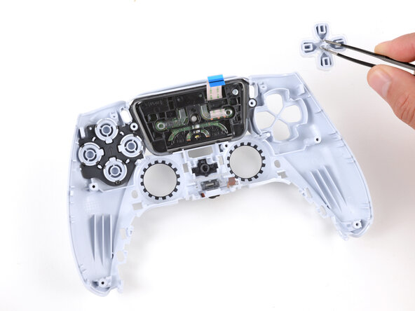

  • Use tweezers or your fingers to remove the Action, PS, and Directional buttons.
  • Alternatively, you can slowly flip the front case over to let the buttons fall out.
  • During reassembly, use the alignment tabs to orient each button into its recess—each one is keyed specifically for its recess and proper orientation.
