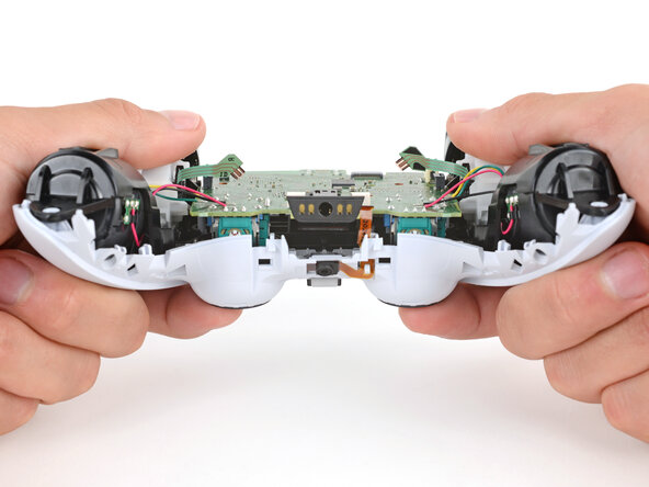

  13. DualSense Controller V5 Buttons Replacement: crwdns2935265:013crwdnd2935265:01crwdnd2935265:02crwdne2935265:0 DualSense Controller V5 Buttons Replacement: crwdns2935265:013crwdnd2935265:02crwdnd2935265:02crwdne2935265:0
    • Lay your controller upside down so the joysticks are on your work surface.
    • Hold the controller down with your fingers and use your thumbs to lift the rear case away from the controller to fully separate it.

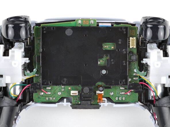

  15. DualSense Controller V5 Buttons Replacement, Disconnect the battery: crwdns2935265:015crwdnd2935265:01crwdnd2935265:02crwdne2935265:0 DualSense Controller V5 Buttons Replacement, Disconnect the battery: crwdns2935265:015crwdnd2935265:02crwdnd2935265:02crwdne2935265:0
    • Don't try to fully remove the battery, as it's still connected to the controller by delicate cables.
    • Swing the battery out of its recess so you can access its connector, making sure to not strain the cables.
    • Keep the battery supported so it doesn't fall during the next step.

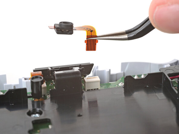

  18. DualSense Controller V5 Buttons Replacement, Remove the lower microphone: crwdns2935265:018crwdnd2935265:01crwdnd2935265:02crwdne2935265:0 DualSense Controller V5 Buttons Replacement, Remove the lower microphone: crwdns2935265:018crwdnd2935265:02crwdnd2935265:02crwdne2935265:0
    • Use tweezers to grip the lower microphone cable's plastic tab and pull it straight out of the socket to remove the microphone.
    • During reassembly, make sure the microphone has its rubber gasket and that the alignment tab goes into its cutout.

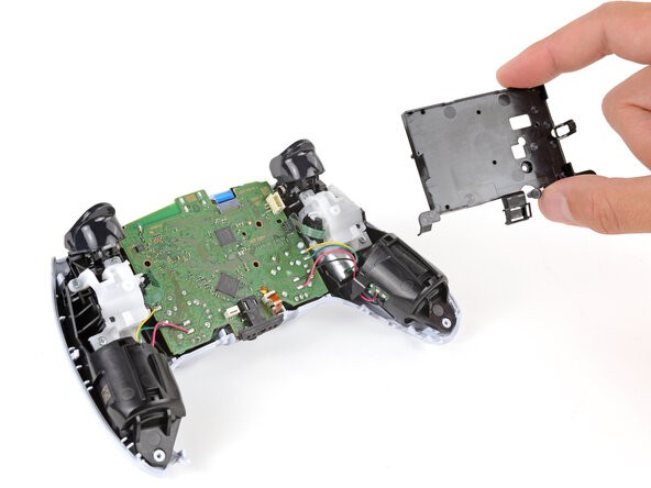

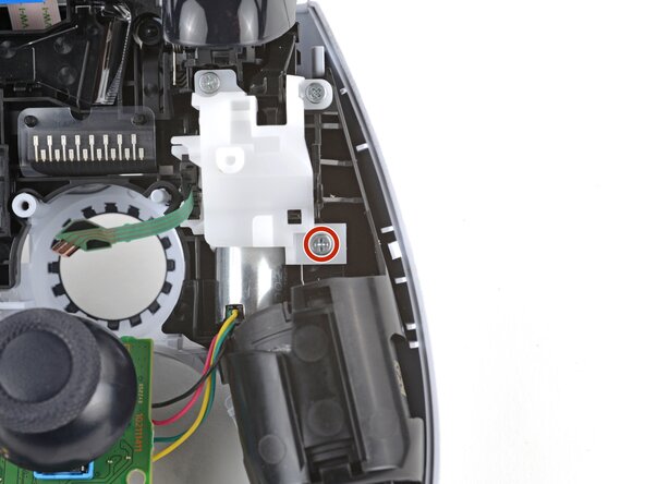

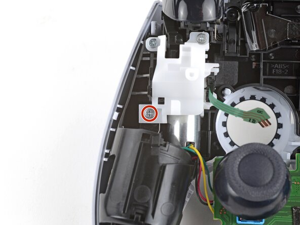

  19. DualSense Controller V5 Buttons Replacement, Remove the battery bracket: crwdns2935265:019crwdnd2935265:01crwdnd2935265:02crwdne2935265:0 DualSense Controller V5 Buttons Replacement, Remove the battery bracket: crwdns2935265:019crwdnd2935265:02crwdnd2935265:02crwdne2935265:0
    • Use a Phillips screwdriver to remove the 6.5 mm‑long screw securing the battery bracket.
  20. DualSense Controller V5 Buttons Replacement: crwdns2935265:020crwdnd2935265:01crwdnd2935265:02crwdne2935265:0 DualSense Controller V5 Buttons Replacement: crwdns2935265:020crwdnd2935265:02crwdnd2935265:02crwdne2935265:0
    • Remove the battery bracket.

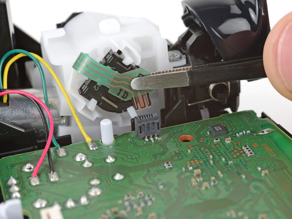

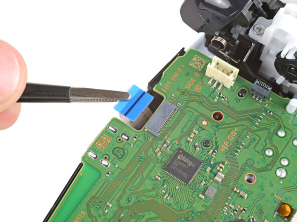

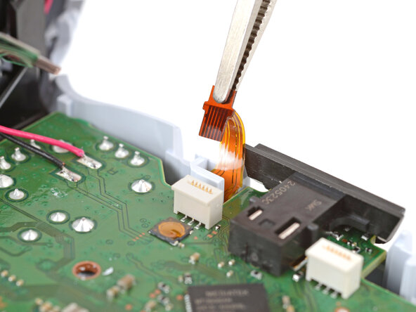

  21. DualSense Controller V5 Buttons Replacement, Disconnect the motherboard: crwdns2935265:021crwdnd2935265:01crwdnd2935265:02crwdne2935265:0 DualSense Controller V5 Buttons Replacement, Disconnect the motherboard: crwdns2935265:021crwdnd2935265:02crwdnd2935265:02crwdne2935265:0
    • Use tweezers to grip the hard plastic section of the right trigger ribbon cable and pull the cable straight out of its socket to disconnect it.
    • If you're having trouble, try gripping the tweezers as close to the cable as possible to get a better hold.

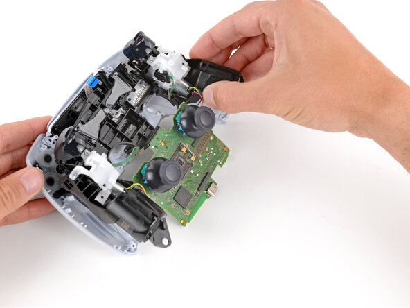

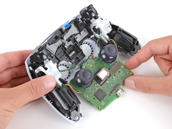

  23. DualSense Controller V5 Buttons Replacement, Reposition the motherboard: crwdns2935265:023crwdnd2935265:01crwdnd2935265:02crwdne2935265:0 DualSense Controller V5 Buttons Replacement, Reposition the motherboard: crwdns2935265:023crwdnd2935265:02crwdnd2935265:02crwdne2935265:0
    • Throughout the rest of your repair, be very careful not to strain the delicate wires attached to the bottom edge of the board. They can easily tear, requiring soldering to fix them.
    • Use your fingers to gently push the joysticks through their cutouts on the shell to separate the motherboard.
  24. DualSense Controller V5 Buttons Replacement: crwdns2935265:024crwdnd2935265:01crwdnd2935265:02crwdne2935265:0 DualSense Controller V5 Buttons Replacement: crwdns2935265:024crwdnd2935265:02crwdnd2935265:02crwdne2935265:0
    • Carefully flip the motherboard down so the joysticks are facing up.

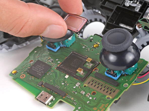

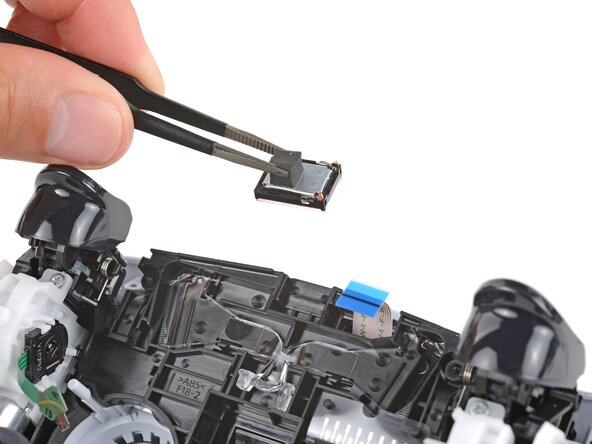

  25. DualSense Controller V5 Buttons Replacement, Remove the speaker: crwdns2935265:025crwdnd2935265:01crwdnd2935265:03crwdne2935265:0 DualSense Controller V5 Buttons Replacement, Remove the speaker: crwdns2935265:025crwdnd2935265:02crwdnd2935265:03crwdne2935265:0 DualSense Controller V5 Buttons Replacement, Remove the speaker: crwdns2935265:025crwdnd2935265:03crwdnd2935265:03crwdne2935265:0

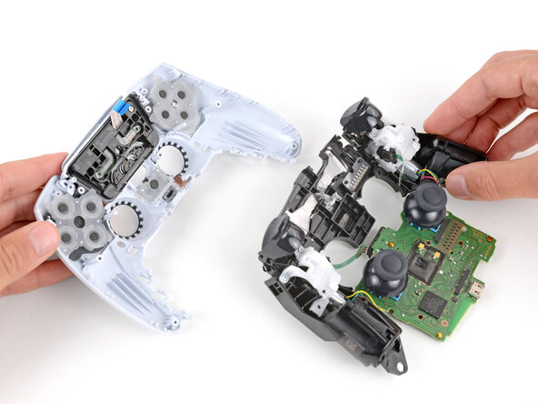

    • Use a Phillips screwdriver to remove the two 6.5 mm‑long screws securing the midframe.
  27. DualSense Controller V5 Buttons Replacement: crwdns2935265:027crwdnd2935265:01crwdnd2935265:03crwdne2935265:0 DualSense Controller V5 Buttons Replacement: crwdns2935265:027crwdnd2935265:02crwdnd2935265:03crwdne2935265:0 DualSense Controller V5 Buttons Replacement: crwdns2935265:027crwdnd2935265:03crwdnd2935265:03crwdne2935265:0
    • Carefully lift the midframe and motherboard up and out of the front case.

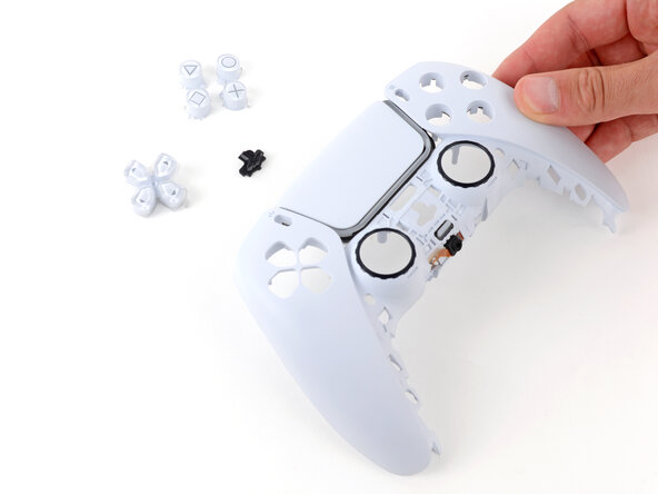

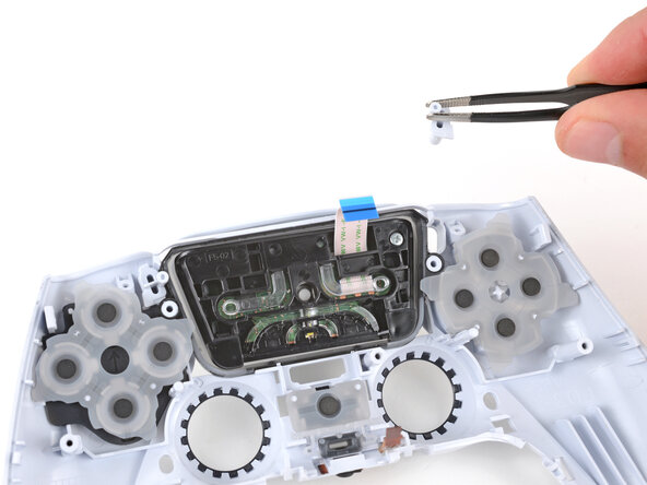

  28. DualSense Controller V5 Buttons Replacement, Remove the buttons: crwdns2935265:028crwdnd2935265:01crwdnd2935265:03crwdne2935265:0 DualSense Controller V5 Buttons Replacement, Remove the buttons: crwdns2935265:028crwdnd2935265:02crwdnd2935265:03crwdne2935265:0 DualSense Controller V5 Buttons Replacement, Remove the buttons: crwdns2935265:028crwdnd2935265:03crwdnd2935265:03crwdne2935265:0
    • Use tweezers or your fingers to remove the Options and Create buttons.

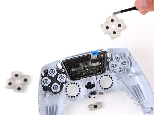

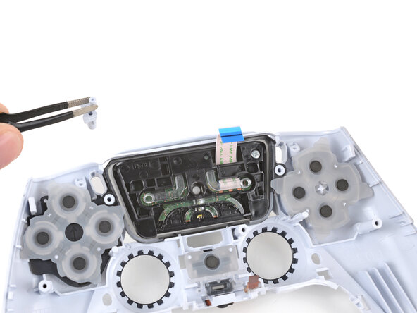

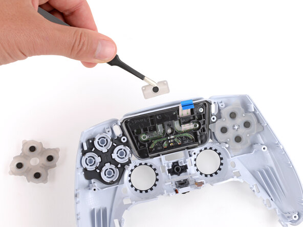

  29. DualSense Controller V5 Buttons Replacement: crwdns2935265:029crwdnd2935265:01crwdnd2935265:03crwdne2935265:0 DualSense Controller V5 Buttons Replacement: crwdns2935265:029crwdnd2935265:02crwdnd2935265:03crwdne2935265:0 DualSense Controller V5 Buttons Replacement: crwdns2935265:029crwdnd2935265:03crwdnd2935265:03crwdne2935265:0
    • Use tweezers or your fingers to remove the three silicone pads covering the Action, PS, and Directional buttons.

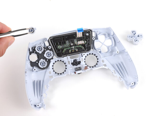

  30. DualSense Controller V5 Buttons Replacement: crwdns2935265:030crwdnd2935265:01crwdnd2935265:03crwdne2935265:0 DualSense Controller V5 Buttons Replacement: crwdns2935265:030crwdnd2935265:02crwdnd2935265:03crwdne2935265:0 DualSense Controller V5 Buttons Replacement: crwdns2935265:030crwdnd2935265:03crwdnd2935265:03crwdne2935265:0
    • Use tweezers or your fingers to remove the Action, PS, and Directional buttons.
    • Alternatively, you can slowly flip the front case over to let the buttons fall out.
    • During reassembly, use the alignment tabs to orient each button into its recess—each one is keyed specifically for its recess and proper orientation.
