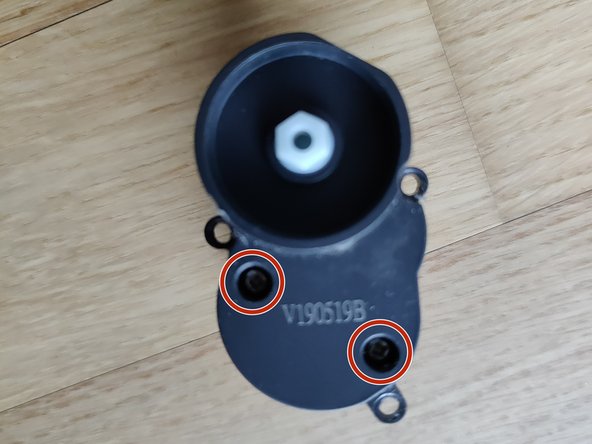

Open the gearbox
  • Remove the 2 screws of the gearbox.
  • Carefully lift of the lid (try not to break the clip or loose the gears)
  • Pull the 2 white plastic gear wheels off to the top (potentially inspect those for damage while it's open anyway).
