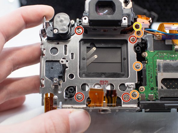

  • On the back of the camera, remove the following screws holding the metal bracket in place:
  • Four M1.7x5.5mm Phillips #000 screws
  • Three M1.7x5.0mm Phillips #000 screws
  • One M2.0x4.3mm JIS #000 screw
  • Pull off the metal bracket, being careful not to damage any of the ribbon cables.
