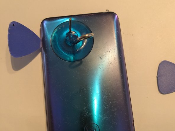

Remove back panel
  • Same procedure as the front. If necessary, use the hairdryer to loosen the glue. Damaging the finish seems inevitable, but you'll cover the back with a case anyways.
