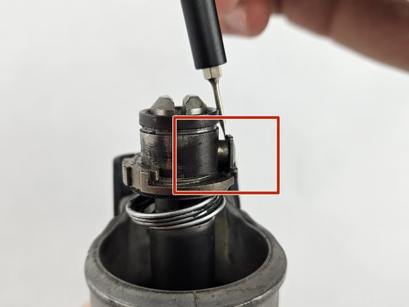

  • To replace the torsion spring, use the flathead to pry the retaining pin beneath its square head.
  • Pull the retaining pin out.
